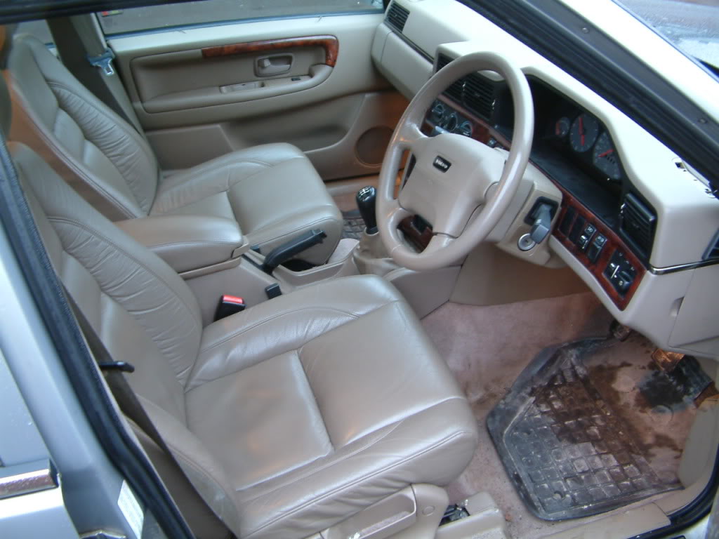

    Do you have som inside pics?

    interior pictures? Very nice car and good work on the front bumper

    Nice car more pictures have been nice

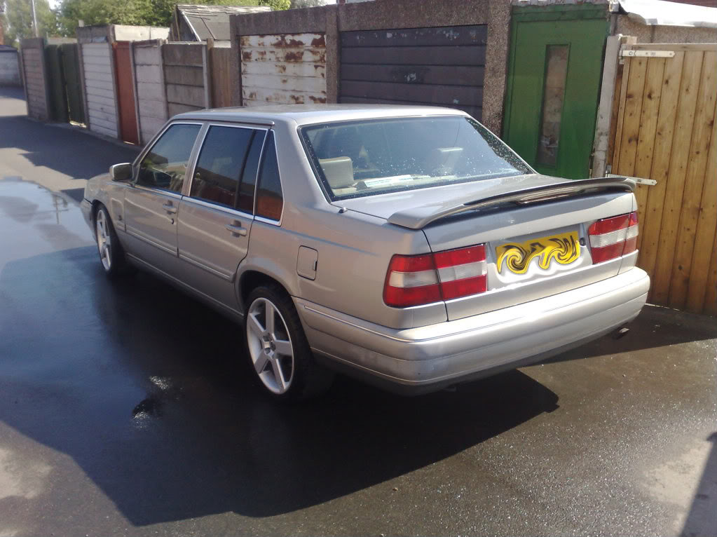

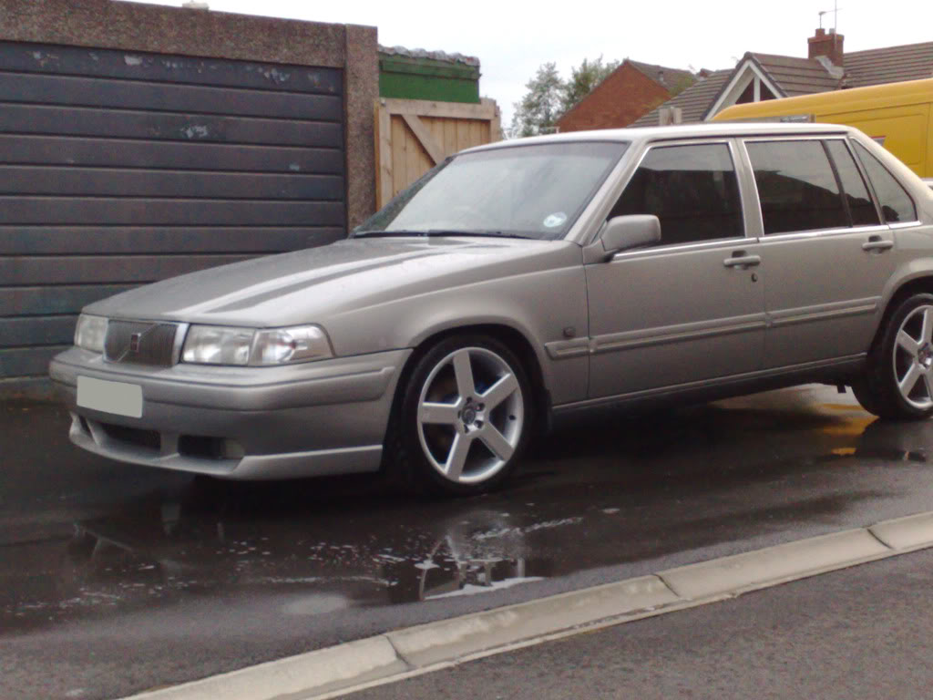

    Here's a few more photo's for those that where interested, the interior is totaly standard(bar the tints), I want to swap it out at some point as I hate the colour of it.
