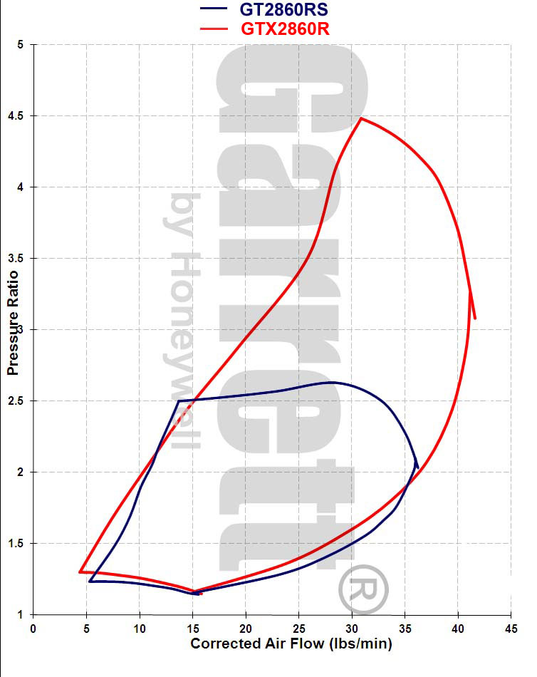

If you look at a 16T compressormap, you will see a capacity of about 435 cfm @ 2.0 PR. 435 cfm is almost 30 lb/min. and 2.0 PR is about 0,9 BAR boost in the intake manifold.
This tells us that at 16T compressor i able to support an engine produsing 300 hp with 0,9 BAR boost and ergo support an engine that flows enough air to support more than 150 hp naturally aspirated.
D-cam and V-cam is similar and can be viewed as something like a 135 NA hp camshafts. 300 hp turbo divided by 135 hp engine gives us 2,22 BAR MAP = safte up to 1,22 BAR boost.
A 16T turbocharger is safe for use with a V-cam equipped B230 engine running about 1,2 BAR boost.
Precision turbo and Turbonetics can not be bothered to produce compressor maps. Americans obviously usually just test their way to find what works for them. Theory and thinking seems to very painfull for large numbers of them so no need for P&T us use loads of money to make compressormaps that most people do not know how to use anyway. Just look at the LS-engine community. Yikes.
