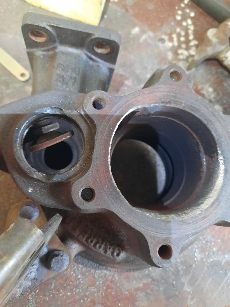

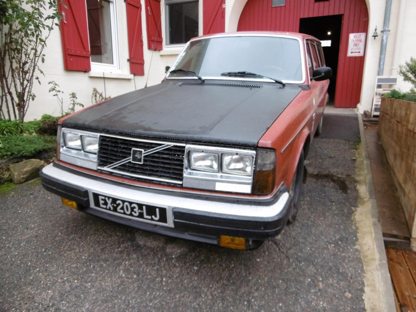

I have a 1979 volvo 245 with a B19, I had modified it in a B19AT ( modified the 175cd-2se carb , b21AT needle, plug the holes, mechanicall fuel pump with boost pressure, 103 ignition with big bell and manifold/turbo/oil cooler/intercooler from a B200ET) it's run great with aprow 130/140CH with 0.5/0.6bar boost pressure.
