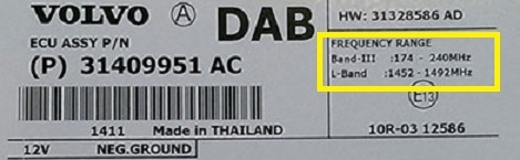

I have been following the thread for your DAB upgrade (using Google Translate) as I am hoping to do something similar myself on my MY13 V40 D2 which was built without the 'DAB Prep' option.
There are 2 antenna inputs on the DABM module as DAB has 2 different frequency bands allocated to it - VHF Band III (174-229Mhz, just above the FM radio band, and so is sometimes called 'DAB FM') and L-Band (1452-1492Mhz, in the middle of the 2 GSM mobile bands). The L-Band frequencies were supposed to be a worldwide standard but apart from a few countries it hasn't been used. In the UK it was used for some test broadcasts, but our DAB transmitter network only operates in the VHF/FM band.
The DABM supports both bands (in the upper right corner of the label on the front panel it shows the 2 frequency bands), which is why it has 2 seperate antenna inputs.
http://forum.vccn.no/img-dump/2015/07/381.jpg
The VHF input comes from the amplifier module connected to the window antenna. On some cars, like the V40, the amplifer module has 2 outputs (FM and DAB) from a common window antenna, as the frequency bands are close enough to be received from the same antenna.
http://forum.vccn.no/img-dump/2015/07/382.jpg
The L-Band input comes from the receiver in the sharks fin. As L-band is much higher frequency it uses a smaller antenna (very similar to a GSM antenna) which is why it's mounted in the sharks fin with the other high-frequency antennae that work best when mounted outside the car.
I don't know about Norway, but as the UK hasn't used the L-Band frequencies for DAB so far (I believe the frequencies have actually been sold off for other uses) the shark fin DAB antenna is effectively redundant here anyway. From what I have read the few countries that did use L-Band for DAB have started migrating services back to VHF Band III instead (although L-Band works OK for cars with an external antenna, the higher frequencies do not propagate as well through buildings for home reception as the VHF band frequencies)
Even if Norway does use L-Band for DAB, I don't think connecting your second VHF-band antenna to to the DABM's L-Band input will do anything, as the antenna is tuned for a much lower frequency band.

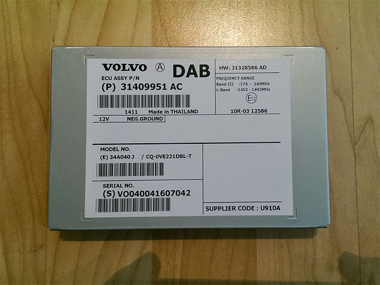

Det er helt umulig å svare på spørsmålet ditt. DABM i Volvo er produsert spesielt for Volvo og meg bekjent finnes det ikke åpen tilgang på teknisk spesifikasjon for modulene. Kontakter og tilkoplinger er nok like på denne boksen og på Volvo-boksen.
Her er bilde av DABM for DAB+ for V70/XC70 2008-2011 (mulig høyere modeller også).

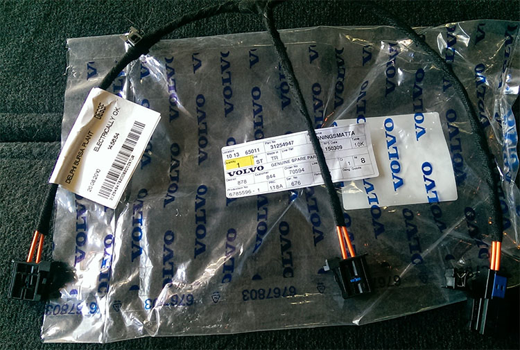

Til dere som lurer på å legge fiberkabel fra forsterker i V70/XC70 og bak til DAB-modul:
Kan man faktisk bruke Volvo sin originale MOST-splitt ved forsterker og en 100 cm fiber med han-hun bak til DABM? Ønsker man å installere original SUB så kan man også bruke en original fibersplitt bak ved SUB (mellom SUB og DABM).
Bilde av Volvo original fibersplitt med varenummer VO31254947, ledningsmatta, kr 450:
http://forum.vccn.no/img-dump/2016/06/237.jpg
Eksempel på ferdig skjøtekabel på 100 cm fra Kina: http://www.ebay.com/itm/MOST-Optical...-/262294588420.
Da drar man ut fiberkabel (han) i forsterker, kopler denne til hun-plugg i splitter, setter han-plugg i splitter i forsterker, og plugger i andre enden med han-plugg i hun-plugg i skjøtekabel som går bak til DAB-modul. Der koples han-plugg i DABM.
Man kan selvsagt få laget en komplett kabel i Norge med aktuelle plugger og riktig lengde om man har tilgang til verktøy og materialer.
Noen kommentarer til dette? Noen som har laget en komplett kabel? Pris?
